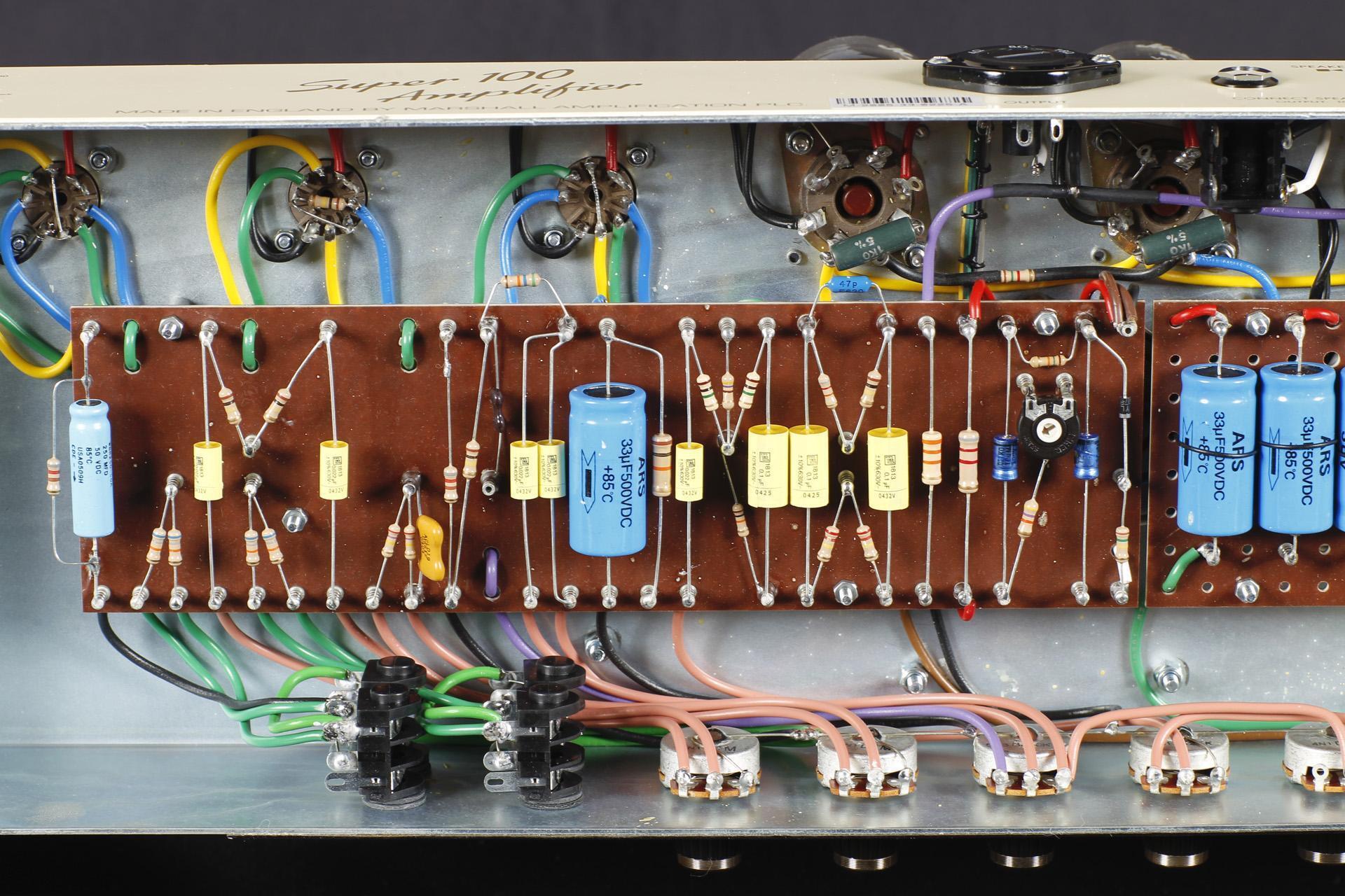

martin manning wrote: Wed Mar 20, 2024 10:16 am The power transformer is inside the chassis and fully enclosed (with end bells). As you can see, the small size places everything in very close proximity.
Can a faulty PT unit or a badly designed PT leak more flux than the best ones? Does the end bells have any part in this?

Richard1001 wrote: Wed Mar 20, 2024 9:29 am I have the exact same Ceriatone C'lator with five differences:
1. The transformer is outside the chassis.
2. All metal parts are have reference ground to chassis (pots, switches etc.)
3. High quality shielded cable.(Both inside the unit and to connect the unit to an amp)
4. Two chassis grounds. (1= IEC + first capacitors of the powersupply / heater; 2 = Signal + both 33uf powersupply capacitors)
5. All chassis grounds have washers with teeth that grip into the metal and the paint is removed to ensure good connection.
I use the C'lator for practice, (very) loud stage volume and on different amps. No hum or noise, no ground loops, no problems.
Mine was pretty much the same, except the transformer location and missing bells.
All jacks, pots and switches are connected to ground as you state in (2). Will however double check that they make physical contact directly to the chassis and not just by wire. I use a Mogami shielded cable from C-lator to amp, and have tried other cables as well (3). And all chassis grounds have washers as you state in (5).
Posts: 14064
Re: C-lator hum
ynor wrote: Wed Mar 20, 2024 10:37 amCan a faulty PT unit or a badly designed PT leak more flux than the best ones? Does the end bells have any part in this?
Definitely. The shape of the EI core is pretty standard, but inferior material, core construction details, and the winding pattern will affect the leakage. I believe enclosing the transformer helps contain the magnetic flux.

I think the next move will be to disconnect the secondary side of the PT and note the results. Then disconnect the PT completely, move it out of the chassis, extending every lead and putting the PT 30 cm away from the chassis. If it's flux, that should be too far away to interfere with anything in the chassis. Correct? Will I need to connect the feet of the PT to chassis ground?
Will also double check that the pots have connections directly to the chassis and not only grounded by the ground bus and wire to signal ground.
Posts: 14064
Re: C-lator hum
Sounds good. The first thing is to see if there is hum with only the PT primary connected. If so that means the source is the PT. Relocating the PT outside the chassis and connecting it with temporary leads would be the next step to see if position or electrical contact with the chassis is the path.
You could take the nuts off the controls and look to see if there is good contact between the pot housings and the chassis (i.e. with internal-tooth star washers), but you have already confirmed that there is ~0 ohms resistance between circuit ground and the pot housings. I am not a fan of soldering a bus to the pots to ground the housings. It is generally messy and unnecessary.
