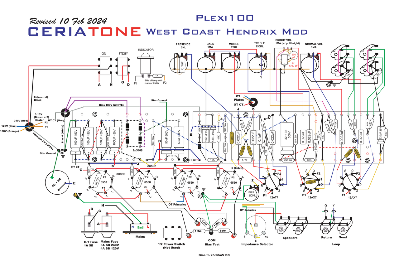

The amp that was the original inspiration for the B+/2 screen supply was the Ceriatone JTM100 JH West Coast mod. There they switch the screens ON with the SB. But in another thread someone pointed out that V2 would have high voltage on it in SB and stress V2.
So I'm trying to avoid that issue. I do have a DPDT SB switch.

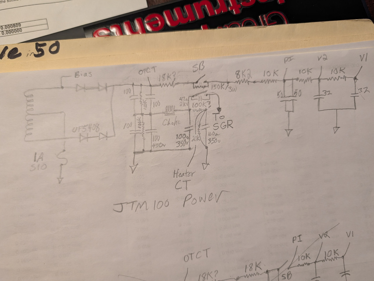

Roe wrote: ↑Fri Aug 07, 2026 8:23 am
Fischerman wrote: ↑Mon Jul 20, 2026 12:18 am The amp that was the original inspiration for the B+/2 screen supply was the Ceriatone JTM100 JH West Coast mod. There they switch the screens ON with the SB. But in another thread someone pointed out that V2 would have high voltage on it in SB and stress V2.
yes but this requires an PT with CT and a FULL WAVE BRIDGE Capacitor Input Load
So this would not work? Sorry for sloppy labeling/etc.

Fischerman wrote: ↑Fri Aug 07, 2026 9:57 pm So this would not work?
As said, that won't work.
The screen current will significantly pull down the voltage across the lower cap (while the voltage across the upper cap will increase by the same amount, likely exceeding its rated voltage).
It's way different from a FWB circuit with the CT connected between the caps.
I like Roe's solution.

Helmholtz wrote: ↑Fri Aug 07, 2026 10:39 pm
Thanks! I was originally going to just add an extra 'node' in the power supply for lower screen voltage but was advised against that earlier itt. But that advice was probably in the context of a FW Bridge rectifier.
I'm really just trying to make a high voltage (560-ish vdc) JTM100 with 6550s that won't blow up or eat tubes. The transformers are built. The extra node seems like the easiest path now.
