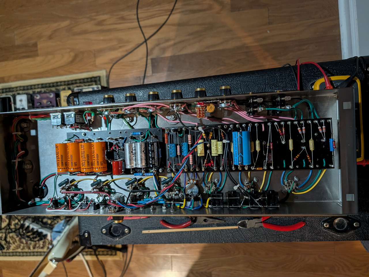

Initial build done but there is a hum. It goes away when I remove V2 but not when I remove V1. The amp makes what seems like normal sound and gets very loud and everything. Tone and Presence controls work fine. But hum is there when the MV is turned up (you can still barely hear it when MV is OFF). Turning up Bright volume makes it a little worse, turning up Normal volume has no effect.

I finally hooked it up to a load box and really put it thru it's paces. I sort of expected the fully cranked tone to be a little farty in the bass but it's not, it's amazing jumpered with both volumes on 10 (MV on 10). Not nearly as crunchy/distorted as my EVH Superlead but just a killer cranked Hendrix tone with a Strat. The low notes have a nice 'kiss' to the front of the note but the note still has a powerful clarity to it. Even the neck pickup. Some (a lot) of that is probably due to the 12AT7 PI. The 18nF Mustards instead of 22nF probably didn't hurt. I still run the Bass on 2.

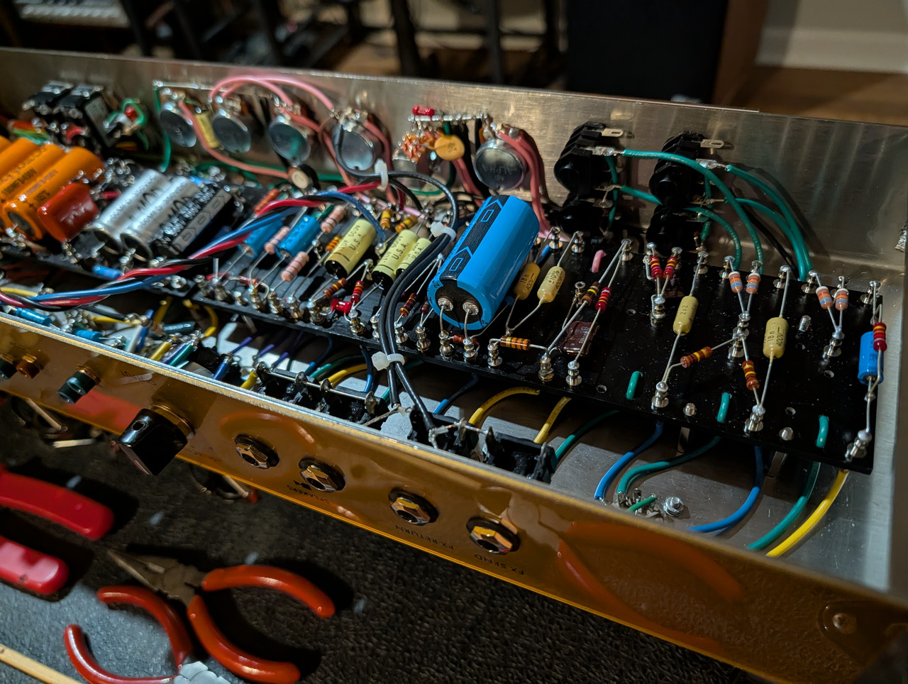

Regarding the hum, I think I've isolated it to the cathode(s) of V2. If I ground the grid of V2a the hum persists. If I pull V2 the hum goes away completely. I redid that ground and the hum improved but is still there. I originally had that ground and the dual preamp filter cap ground on a lug that was combined with (stacked on same bolt) the lug for the Mid/Presence ground buss. But those cathodes were noticeably more quiet when connected directly to the first ground buss (volumes, jacks, v1 cathode).
I think I might remove the bright switch. I've always been a fan of that big ass bright cap in a post-'68 Superlead but it's not right in this amp. That little 47pF dogbone is perfect. Then I might just run a ground buss all the way across the pots and see if that is more quiet. That V2 area is always a 'hot' area for noise.
So, for the record, here's where everything grounds:
IEC to a bolt near back corner between V7 and cap can
Power tube cathodes thru 1 ohm resistors to a bolt between V4/V5
OT secondary CT to speaker jacks, speaker jacks to same bolt as above
Main filter caps to a bolt near V7, near the corner of power board
PT secondary CT to same bolt as above (thru fuse)
Screen caps to a bolt under Presence (reminder: choke-input screen supply, if it matters here)
Bias to same bolt as above
Presence and Mid pots have a buss wire between them that is grounded to a bolt between Vol1/Treble
Volume pots have a buss wire between them that is grounded to a bolt between input jacks
Preamp dual filter grounded to buss above
V2 cathodes grounded to buss above
Input jacks grounded to buss above
Heater CT node from power board grounded to buss above
V1 cathodes connected to Channel two input jack ground
