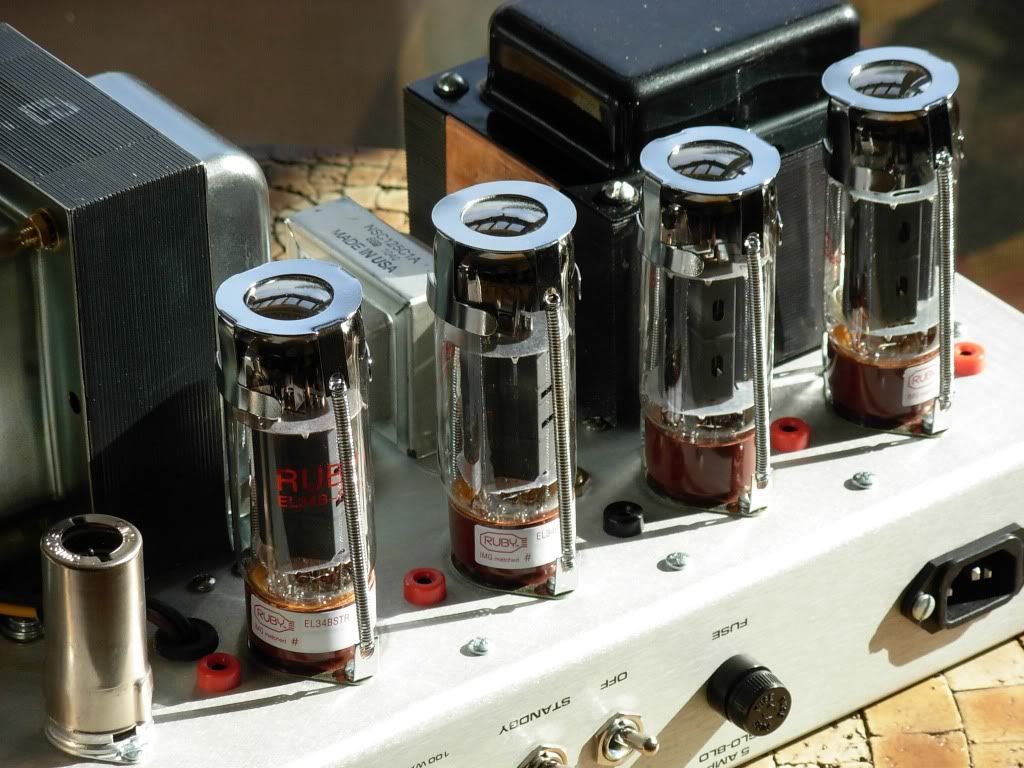

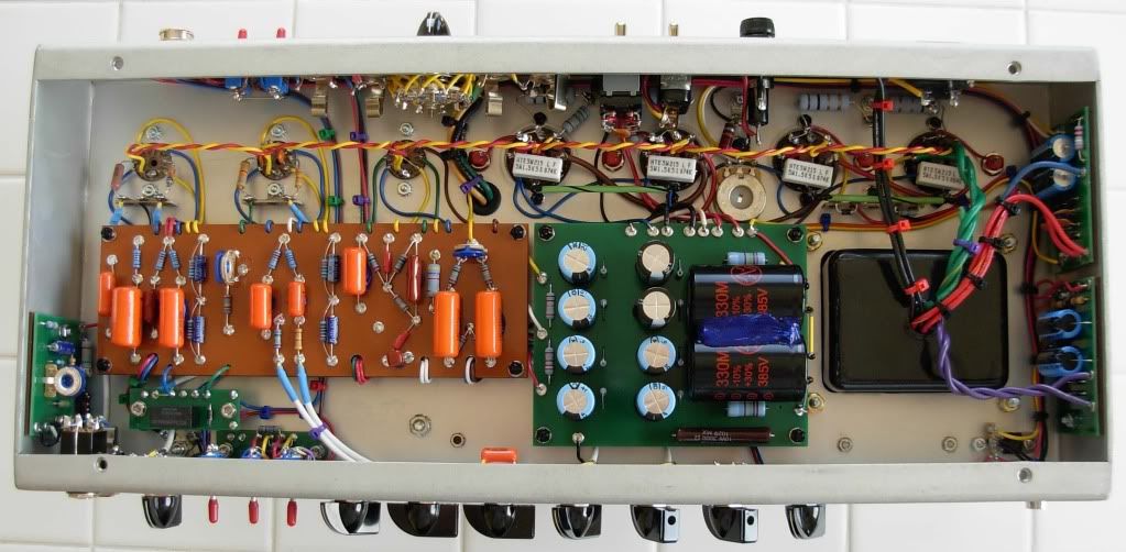

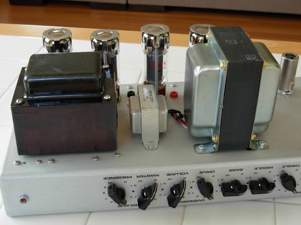

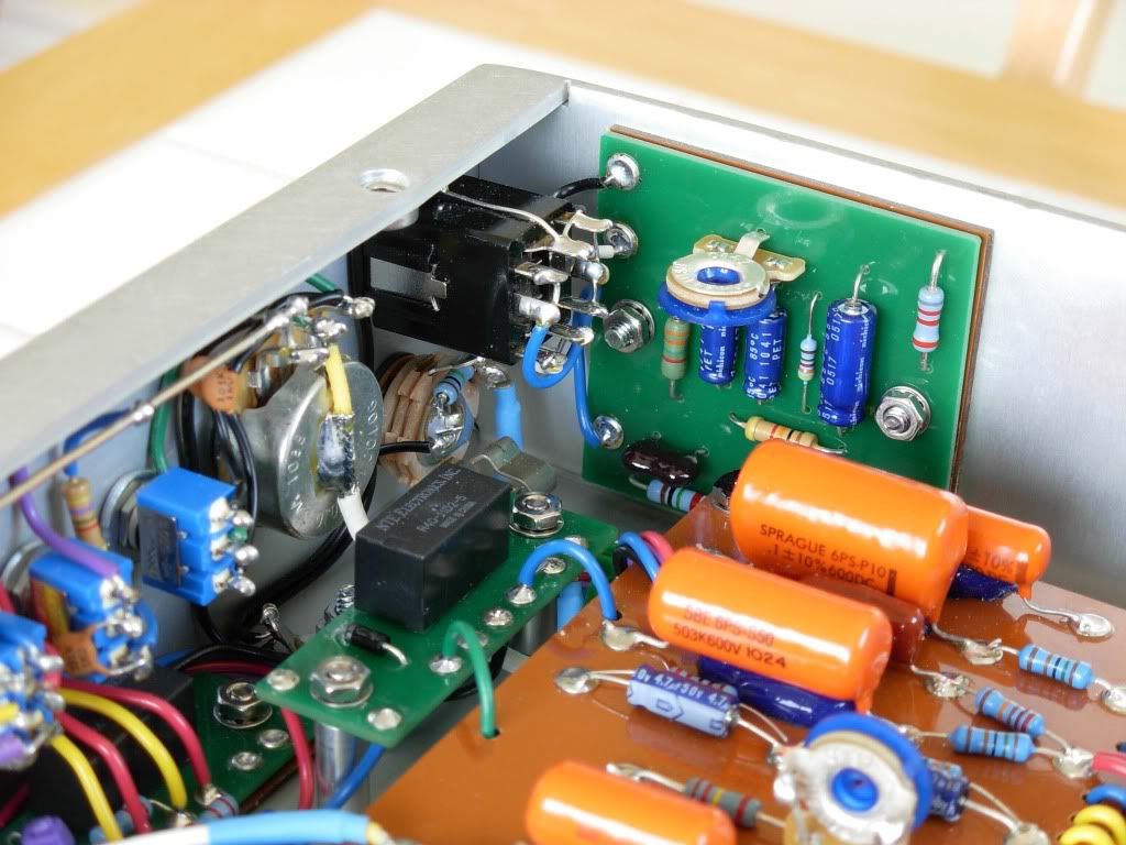

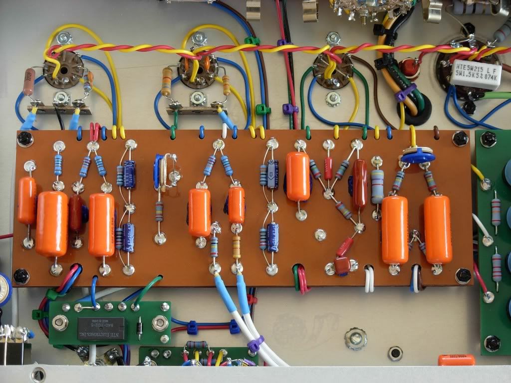

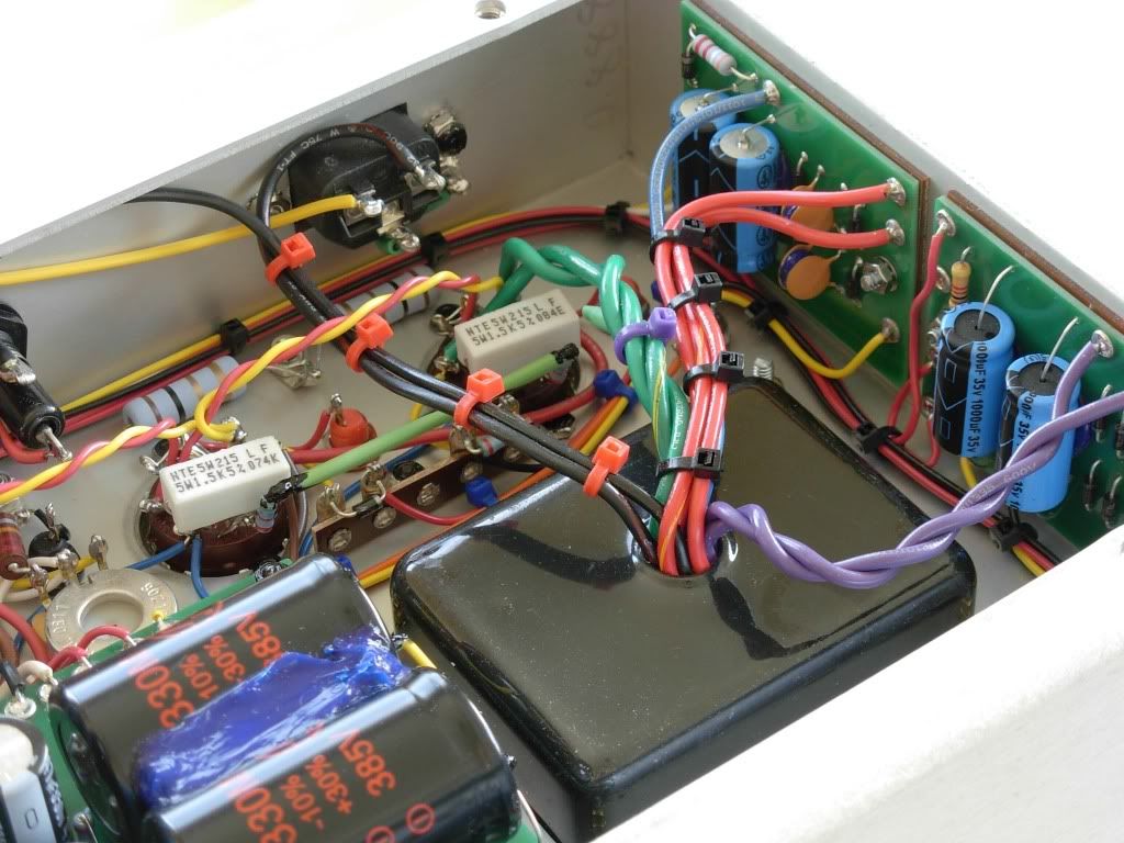

Just finished a 183-type build so I thought I’d show some voltages n’ pics. Big shout out to Billy Yates of Venice Amplifier Company who helped me get it started. Everything would have fired up smoothly if it hadn’t been for a bum EL34. But when it finally did, it sounded awesome!
Tubes are: 2 Chinese 12AX7A for V1, V2 and one Sovtek 12AX7LPS in the PI. Power tubes are Ruby EL34BHT (Chinese).
Transformers: Custom Heyboer PT ordered from Jason aka jborders5, Choke and OT are New Sensor NSC125C1A and MOP-100 respectively.
The HT/rectifier PCB comes from jborders5 and the rest of them were bought from Brandon.
Chassis is the CE chassis.
I’m currently waiting on Jelle to provide a head cab for it. Should be…radical!!!
Also, thanks to Shad for the info on this amp. Exciting circuit!

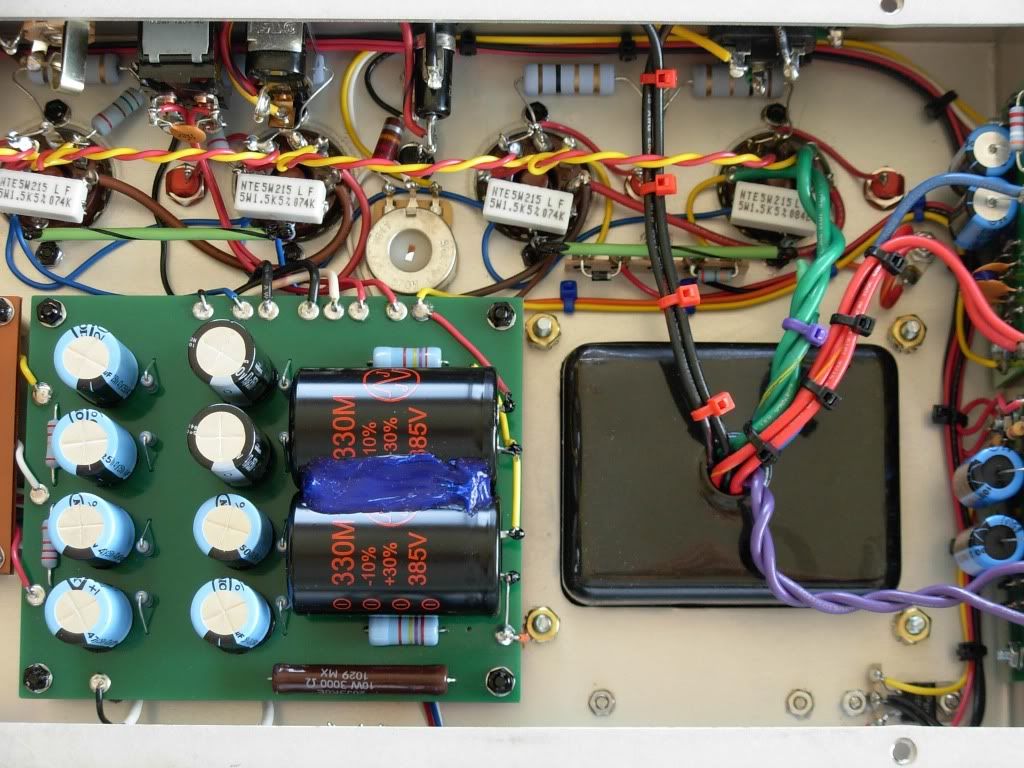

Here are some voltages:
No load B+: 479V
Loaded B+: 462V
Screens: 456V
B+3: 436V
B+4: 321V
B+5: 313V
OD
Pin 1: 214.5V
Pin 6: 207.5V
CL
Pin 1: 200.9V
Pin 6: 189.2V
PI
Pin 1: 295V
Pin 6: 300V
Bias Voltage: -41.2V

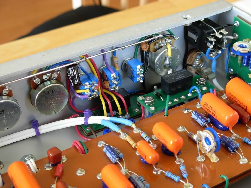

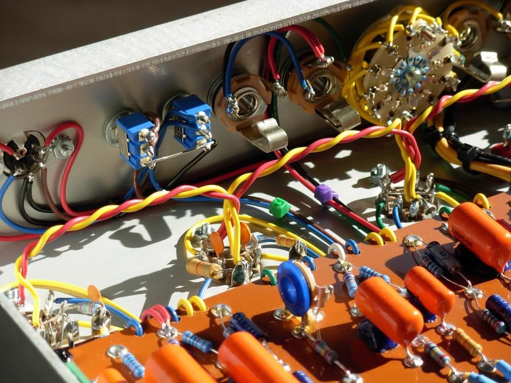

Beautiful work, dig the colorscheme
Forgive my stupidity but what is the switch with all the yellow wires, looks like an impedance switch with like 20 contacts :?

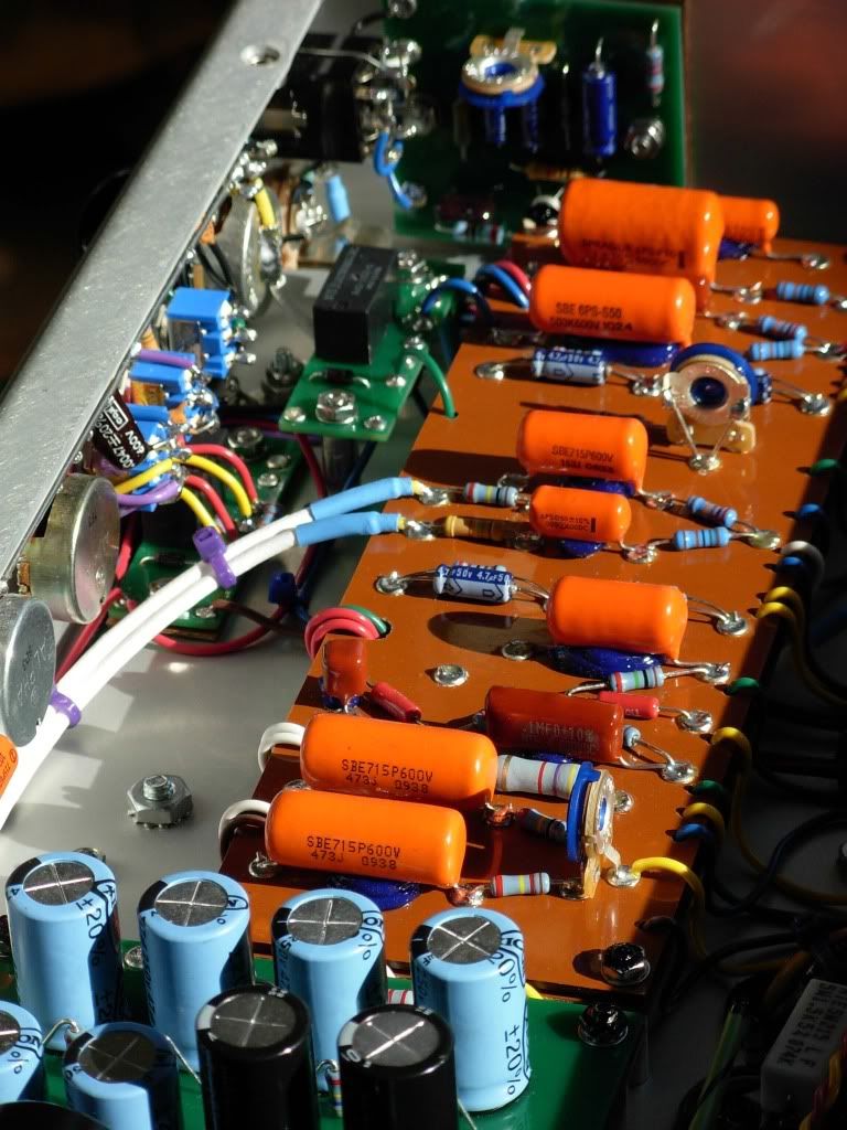

Sweet build Ultra, Dig the CTS trimmers.

Wilcox, see more here bout the switch:
http://ampgarage.com/forum/viewtopic.ph ... ctroswitch
