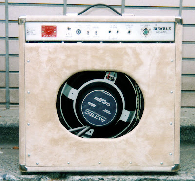

Anybody know which amp this is?
At first I thought it was #40 but the speaker is different.
[img:400:396]http://lh6.ggpht.com/_MHnI-B0pJ8k/TLZLv ... 55-O-1.jpg[/img]
[img:400:372]http://lh5.ggpht.com/_MHnI-B0pJ8k/TLZLv ... 56-O-1.jpg[/img]

Is that not #75?

Hi Grog,Grog wrote:Is that not #75?
the amp on the picture, which Tom (structo) has posted, that looks indeed similar to #040, is a 2nd generation "pre-classic" ODS 50W, but in a rather unusual cabinet for such a 2nd generation ODS combo. If it should really be #040, then the speaker has been changed after or before the pictures which you find on Rob Livesey's site have been taken. The 2nd generation amp in this picture has a 12" Altec 417-8H Series II speaker, AFAIK the usual original speaker of all 2nd and 3rd generation ODS combo amps.
2nd generation "pre-classic" ODS 50W amps, like this one on Tom's picture, have this kind of circuit: http://ampgarage.com/forum/viewtopic.ph ... 751#136751
But ODS #075, the Steve Farris amp, is a transition generation "classic" ODS 100W combo and has this kind of circuit: http://ampgarage.com/forum/viewtopic.ph ... 327#137327
but with some special tweaks done by Alexander Dumble here and there to fine-tune #075 to the personal taste of Steve Farris.
Cheers,
Max

Max wrote:Hi Grog,Grog wrote:Is that not #75?

Thanks Max, so the Farris amp sounds closer to the later Dumbles you think?

Hi Grog,Grog wrote:Thanks Max, so the Farris amp sounds closer to the later Dumbles you think?
the circuit of nearly all the transition generation "classic" amps like #075 is more or less the same one as the one of the 4th generation classic amps which is documented in this layout: http://ampgarage.com/forum/viewtopic.ph ... 327#137327
The only exception I know of is #094, which is a "high plate" classic, but perhaps because it was updated to "high plate" specs at some point:
The reason why I call the ODS amps like #075 or #093 "transition generation" is that they already have most of the 4th generation specs but not the 4th generation look. #075 as an example really looks more similar to #40 than #093, which is already black. But the circuit of #075 is indeed more "advanced" than the circuit of #093, because #075 has already both, a ratio control (on the back) and a full size presence on the front. But #093 still has an accent switch, but it is already a "blackface". Because of all these inconsistancies especially concerning their look and some features (presence or accent) of these "classic" amps from at least #075 to at least #094 I call them "transition generation" classic ODS amps.
